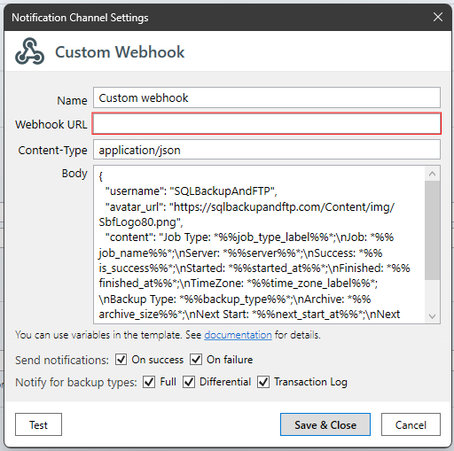

SqlBackupAndFTP can send notifications to Incoming Webhook. To configure it, you need a webhook URL and a request body template that can include job data.
What You Need to Fill In
  1. In the Name field, enter a clear channel name. For example, the name of the service you are calling.
  2. In the Webhook URL field, paste the full webhook address that should accept the POST request.
  3. In the Content-Type field, specify the request body format. Usually this is application/json.
  4. In the Body field, enter the request body template.
  5. If needed, add variables to the Body in the *%%name%%* format.
  6. Select when notifications should be sent: On Success, On Failure, or both.
  7. If necessary, limit sending by Backup types.
  8. Click Test to send a test webhook.

Body Example
  "jobName": "*%%job_name%%*",
  "server": "*%%server%%*",
  "isSuccess": "*%%is_success%%*",
  "backupType": "*%%backup_type%%*",
  "firstError": "*%%first_error%%*"
